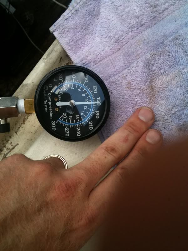

The engine has new oil in it and a new set of plugs (the old ones were horrible). I did the compression test on each cylinder today. I ran the motor with muffs on for a bit, then stopped the water to run the engine up to "warm" before stopping it. I then removed the plugs, grounded the distributor feed, wide-opened the throttle, and hooked up the gauge to cylinder one. When I cranked it, I noticed liquid shot out of plug #3 and onto a rag hanging on the boat rail! I thought it might have been gas, but smelled it, and it was water! doh! I continued the test on all cylinders and then ran the motor dry for a couple minutes to get any residual moisture out of cylinder #3. Here are the findings which I came to expect after seeing the water:
Cylinder 1: =155
http://i96.photobucket.com/albums/l198/jlandin/boat/IMG_0218.jpg

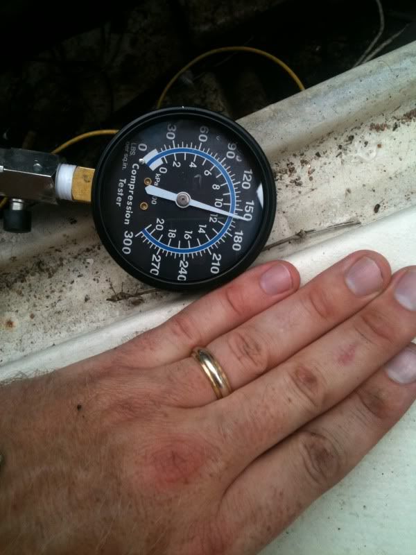

Cylinder 2: =150
http://i96.photobucket.com/albums/l198/jlandin/boat/IMG_0220.jpg

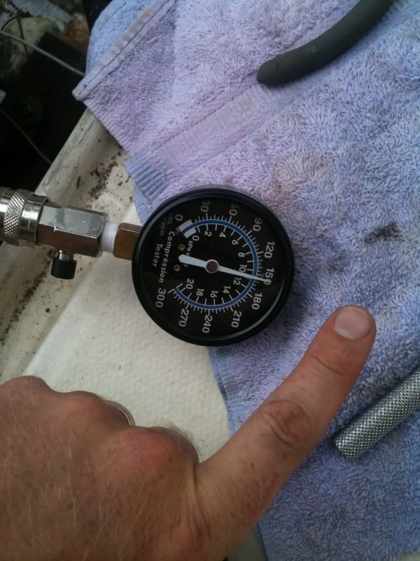

Cylinder 3: = 85
http://i96.photobucket.com/albums/l198/jlandin/boat/IMG_0221.jpg

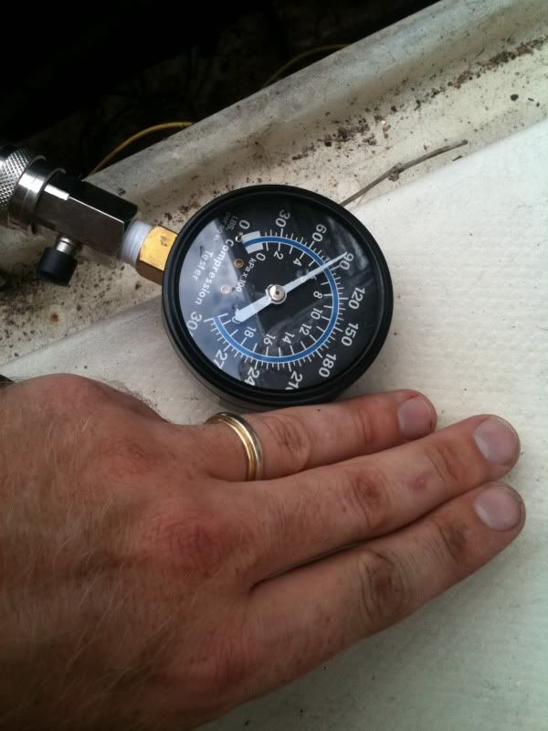

Cylinder 4: = 160
http://i96.photobucket.com/albums/l198/jlandin/boat/IMG_0222.jpg
So, I'm guessing it could be a head gasket or even a cracked/warped head.
I guess my next step is to start breaking it down and pulling off the head right?
