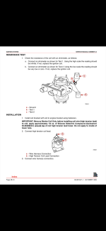

this is out of a merc 5.0/5.7 engine manual specs are same for both the EST coil and TB coil...
Primary side - .6-.8 oms
Secondary - 9,400-11,700 ohms
Attached is a snip of how to test the pick up coil in the est . This is for a delco but Ass/u/me yours is similar
Here is what my test papers say. Which checks out. I am headed to the lake now to grab the new module and play with the timing on the points distributor.
