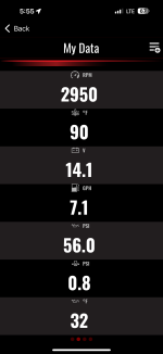

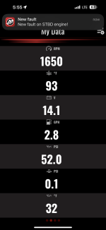

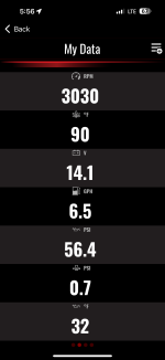

So I connected my vessel view and ran it under load and took multiple snap shots. I am getting an alarm at idle when I first start the boat and again above 3500 rpms. The oil temperature and engine temperature, I believe are very low. The other concern is the water pressure is also very low while under load. Would appreciate any insight.

Yes it seems the water PSI is way to low...So maybe a clog someplace, bad impeller or worn internal housing or failing sensor....Being I'd tend to believe you have an Alpha stern drive? In your case I think I'd start towards inspecting the water pressure sensor which may be mounted near/on the power steering cooler...Item number 16, https://www.mercruiserparts.com/bam/subassemblydetail/43948594/28193445
Pull it and clean it possibly...

Yes, the water pressure is way too low, what doesn't make sense is that if the water pressure sensor is faulty, I would expect that it would throw a code and that the engine temperature isn't anywhere near what it is supposed to be. Which is throwing me for a loop. I ordered a new water pressure sensor, but again it doesn't make sense.

Some of the other readings don't make sense, your engine temp is very low, yet water pressure is also low, with low water pressure you might expect the engine temp to be too high....

exactly! unless the thermostat is stuck open. But shouldn't a code by thrown for that as well?

No, there's no fault code for a cooler running engine that is still within a programed temp range... If that temperature is the temp for after roughly 8 minutes of engine running time at idle, then yes most likely the thermostat might be stuck open either by age, corrosion, and a bit more common 'debris such as rocks/sand and if that may be the case of debris, then maybe the water sensor needs a cleaning as well.
A too low of water pressure would sound the warning horn especially over 3000 RPM...The ECM knows a general range it should be at all RPM's and not necessarily throw a code per se... without one of us from iboats forums being there to help you check it out better, I'd venture to say low water pressure "readings" could be the issue of the alarm even if the engine is not running hot because the sensor thinks it's low when it may not be low...It's time to pull things apart to inspect, back flush then order parts as found needed possibly such as an impeller and related gaskets and impeller housing cover, (< Alpha drive right?) gear oil and a oil fill pump kit, water psi sensor since you already ordered one, MerCruiser 160 degree thermostat kit and maybe a stern drive install gasket in case you have to remove the drive to inspect the water inlet hose area for debris stuck or even just because it's time?

seeing that, id want to take readings with an IR temp gun,,,,

Just purchased one, the water pressure sensor is going to be replaced as well as the thermostat with the other one being tested when removed.
