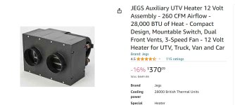

I am looking for a cooling flow diagram to see what ports I can hook up an auxiliary heater to? I want to ensure I don't disrupt the cooling system when installing the heater. I attached a screenshot of an auxiliary heater I've been looking at. Also curious to hear what others have installed on their boats. Any help would be greatly appreciated. Thanks in advance.

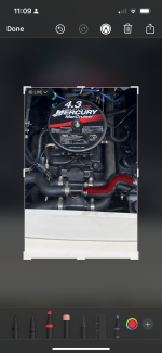

I think I see the plug to the lower right of the spark arrestor. I do recall there being a spare plug on the water pump as well.

Thanks, my serial number is 0W669170 and I believe I have the plug on the top of the manifold there is a sensor on the other side to the left. I do believe I have the pipe plug on the water pump as well. Question is the pipe plug on the water pump for supply? and the plug shown in the picture for return?

Is there a certain heater you'd recommend? or are they all pretty much the same?

They all work pretty much the same, and not many here on this forum have installed one. Don't know how much heat your looking for but having a 4.3 means it doesn't generate as much heat as a 8.2 so think about that when sizing

Yeah I’m just looking for a simple 2 vent one that I can run a couple hoses to the kids when they get out of the water. Being in Northern Alberta Canada the water doesn’t get that warm. Just need a heater to take that edge off. Thanks for all your help. Think I got it narrowed down. I’ll keep you posted how it turns out once I get it installed. Cheers and happy boating.

Double check but I belive the plug you circled goes into the intake runner not water crossover

It lines up with the intake runner water cross over is below the thermostat housing it up pull that plug it will be dry won’t run with that much of a vacuum leak

@Scott06 is correct, the plug on top right is to the intake port number 1, so don't use that
When you first posted a pic of your motor with serial number I took it as a 2006 carb motor and didn't notice the 6 port Thermostat housing so was looking at manual 25. The 6 port hasn't been used much since 1999 (manual 18). Could be yours was a new old stock or for some reason they used it on yours instead of the 6 port
So with that, look on the port side below the top hose and see if the temp sensor is there. If it is do not remove, then look on starboard side on housing on the intake for a plug (is it there)??
