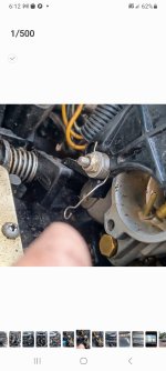

I have a 1988, Mercury 35hp that I just picked up. Looks like the choke plate covers the entire face of the carb. There's a spring on it of which one end is not hooked up. Can someone tell me where it goes?

That spring looks to be bent. If I remember correctly, on my IL6 with the same carbs, the small straight tip should go into the carb shutter, and the loop end should go around a screw which is missing, in the hole at the base of the throat. The screw also held on the plastic grating. See diagram

The Parts Diagram don't show any Anchoring Screw/Post for the Loop. Perhaps it was retained by #42? That Screen is not visible in the Pic you provided
