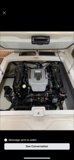

Not sure, picking this boat up next week after a sea trial and I’ll need to winterize it that night.
I’ll just stand on my head and find out.

That's a CAT motor and more then likely it will have a single point drain system. I see a blue plug (I think) on top of the motor, front port side. It may have the air pump drains on the sea water pump. Something like this kind of setup
