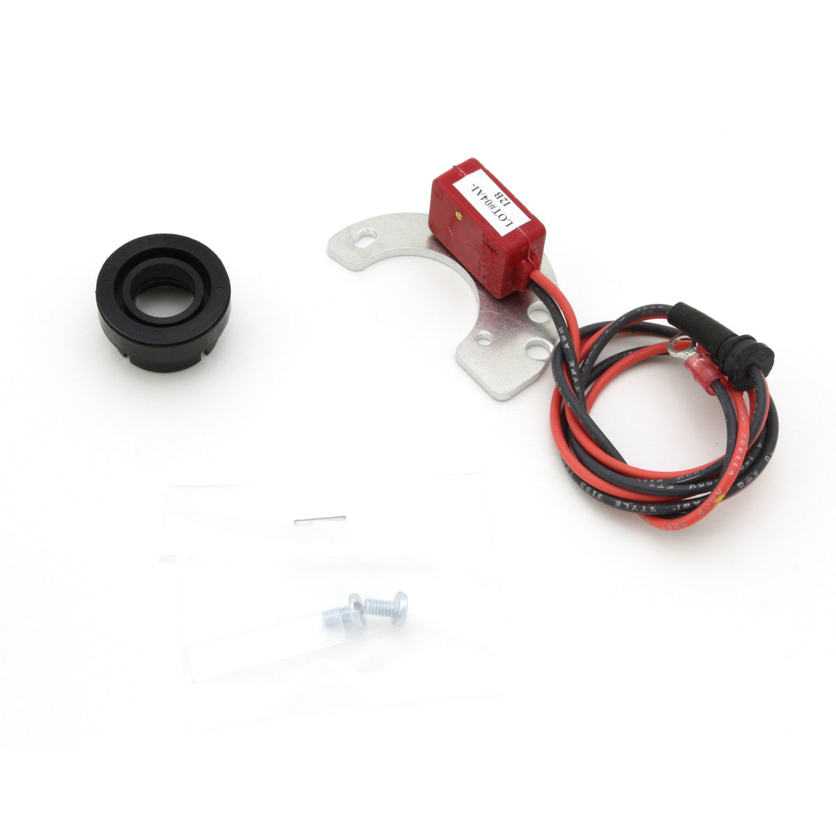

I have an old 302 in my boat and the distributer has no vaccume advance. I want to change it and add a petronix system ...any suggestions

Marine engines can't use a vacuum advance, so a MARINE distributor doesn't have it.
Add the petronix just as you would to a automobile distributor.
Here's the Petronix application chart. Based on your dissy being MM, then it looks like kit# 9MC-181 is the one you're looking for....
