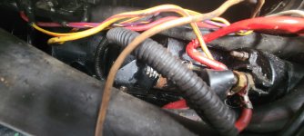

Can you post a picture of the area of the starter and the boost solenoid connecting wires?

Still no farther ahead
Pulled perko switch and eliminated the second factory fuse as there is one already attached to the donkey **** cleaned all the connections on perko switch but still no better..
Could the internal of the switch be the cause as it does the same on each motor so thinking its a bad /broken ground or the switch is not making good contact inside ..
Going to run 2 new ground wires directly to starter bolts from battery which should eliminate if it's a bad ground ...

Think I found the issue found a broken ground wire and now 1 motor is cranking nice and fast .
Have second motors waterpump apart to replace the seals so hoping it has resolved the issue with that one as well
