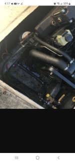

1st pic is the empty engine bay in mine (note the stringers).
2nd pic is a picture I found online of an identical boat with a 4.3. (looks to be the same)
Can I assume this boat has the correct stringers already? I believe it came originally with 2 options, the 3.7 and I thought it was a V8 230 hp. Interested in the V6 because supposedly it bolts to my Alpha one.
What else would be needed to do the swap? I assume wire harness and....?

You'll need to glass in mounts, you don't have what you need there. Don't know how much your boat weighs, but might consider a 5.7. You can use the alpha if you have a light right hand. You don't need wire harness; what you need depends on your donor. You *will* need a junked donor boat, don't try to piecemeal it.

I realize the mounts aren't there and need to be glassed in. The V8 230hp was an option so u was thinking the engine bay was set up for either option. Does that make sense?

If boat was offered with a V8 i would bet those stringers are for v engine mounts. Here is a 5.7 install drawing measure it up iff the gimbal bearing as crankshaft center line
Here is a 4.3 drawing mounts are 4” further back on the sides.https://samerwebapp01apncus01.azureedge.net/mmgw-env-b/filer_public/a6/0e/a60edabe-830a-4a0e-af7c-d296ce044500/43lhalphawithtwo-pieceexhaustmanifold_1996-2001.pdf
for a 21 ft boat id go with a 5.7. Your drive will fit up just has the wrong gear ratio. I did a 4.3 to 5.0 swap kept the V6 drive ratio stepped up from a 19” to 21” pitch prop works great. Given what you lay out i would expect to have to go up 4” in pitch if you kept the same drive. Worst case get a correct ratio upper drive.
