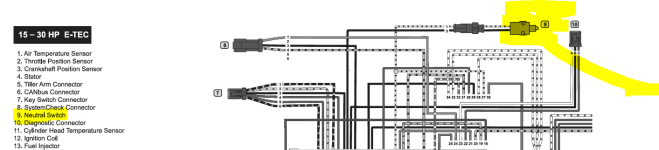

it can be simple things. WHat has been done to check misc stuff like filters in the lift pump, VST return filter injector filter. sticky neutrl satefty switch etc...
check the manual dowwnload it from USER GEBs site on the ETC user board look up the back pages for basic suggestions
