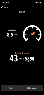

Didn’t know they had a pad…anyway…you’re a good bit down on performance. I’ve got the normal version of this merc engine (but with Ct box)…on a 19ft cuddy cabin sports cruiser. I get around 43gps at nearly 6000 rpm with a tempest 19”. And a couple mph more perhaps, with a 20” enertia at about 6000 rpm. My ratio is 2.38-1…but you’d imagine your boat should do a little better than it is now. Although…as far as I know, the CT versions usually run quicker…just with the props they can use.
I saw a huge difference by raising my engine up a couple of holes on the transom. Baystar steering transformed things too.
I alswats use the smartcraft gauges or vessel view read out, just so you know your data is accurate.
