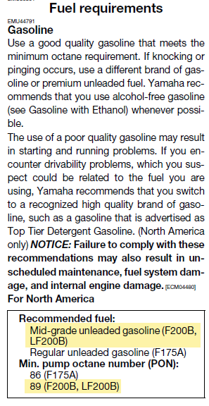

Curious on what fuel is best for this engine. Thanks

J Jeff J Chief Petty Officer Joined Jun 23, 2021 Messages 604 Sep 13, 2025 #2 What does the manual say? It is available to download free from Yamaha.
J Jakem Lieutenant Junior Grade Joined Apr 25, 2021 Messages 1,104 Sep 14, 2025 #3 I didn't know I could download it free
B boscoe99 Commander Joined Aug 22, 2013 Messages 2,330 Sep 14, 2025 #5 How can an answer be given without knowing what F200 we are talking about? Why, oh why, is it so very difficult to type a few more letters?
B boscoe99 Commander Joined Aug 22, 2013 Messages 2,330 Sep 14, 2025 #6 If the OP is in the USA, then I suspect that he has an F200LB, an F200XB/LF200XB or an F200XB2/LF200XB2.
