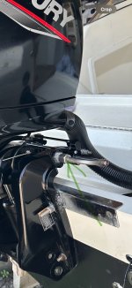

I was able to find only one grease Zerk location. The grease zerk I found is in the middle of the engine's column. See attached picture (right behind where I'm pointing at). I added some marine grease with a grease gun )some grease came out of the lower column but not the top. The steering got a little better after adding grease there, but I still feel some resistance. Please let me know if there are other places where I can add grease to it,
Nope, that's it.
If pumping new grease in doesn't clear the old grease and restore operation, you need to tear it down to clean *** out.
FWIW.... picture appears to still have cable steering connected

What do you mean? "the cable steering seems to be connected". Was I supposed to remove something?
I think I should add more grease to get all the old grease to come out the bottom of the steering column. The color of the old grease was whitish/light brown.

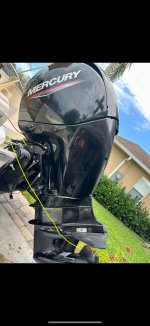

Hey Chris, do you have any pics of how you tied the rope (or a quick drawing). I understand tying a rope under the anticavitaion plate, but I'm not sure how to put it around the transom bracket or where/how to place the pipe to create the torniquet like force. Did you have to lose any bolts. Or just apply some force to the the steering column to separate a little IOT get the grease to come out the top? THANKS!

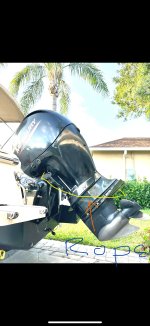

Should I run the strap or rope through the transom bracket like this? (Of course, I would run the rope under the steering support bracket and lines). Also, I would make sure the engine is tilted all the way up. Tks!

I think the picture has it correct. Tilt the motor up to lighten the pressure on the top bushing. Wiggle the motor steering while tigntening the strap.
Some heat might help soften the old grease.
If that all fails, you could drop the trailer tongue, put some sort of block under the anti ventilation plate and skeg and jack up the trailer to cause the engine to lift up. That could cause damage to the engine, so be real careful.
