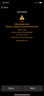

Hi. The most obvious reason for this would be bad fuel or clogged filter perhaps. Do you have smart craft gauges or vessel view mobile installed ? A shift interruption error would come up on these. Like mine below
