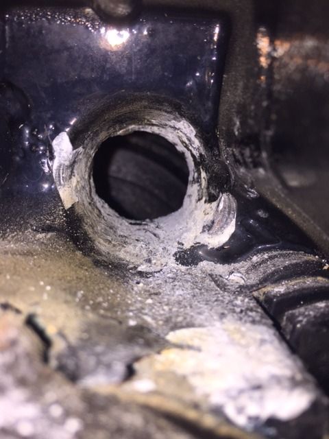

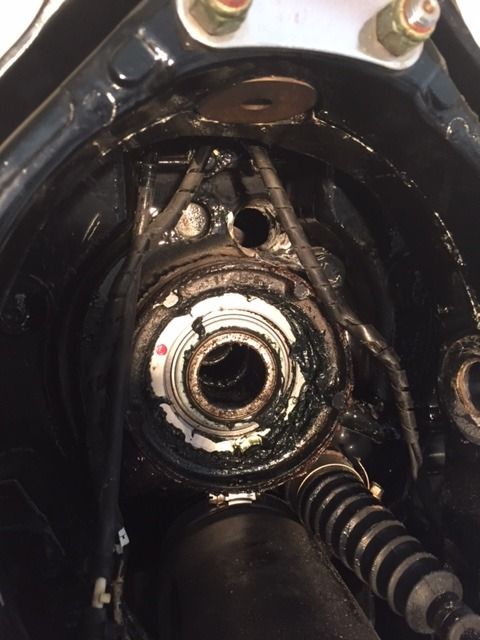

Sounds like your boat could be slowly developing "Bravoitis". Mine did the same thing (2003 8.1L with B3) as yours. Mostly used in fresh water, maybe 5% in brackish. Started as intermittent last year, this year it gradually got worse. I also replaced my stock brass pump (slightly scored) with the Hardin stainless pump in an attempt to fix it. My Smartcraft gauge showed a "Low Water PSI" warning when it happened. It's a common problem, a couple of companies make kits to fix it:
http://www.hardin-marine.com/p-74054...epair-kit.aspx
http://www.amarket.com/BRAVOitis.htm
http://www.amarket.com/IM654.htm
I put the Hardin kit in mine, everything is happy now.
Water hose tunnel is the hole at about 1 o'clock just above the gimbal bearing. The rest of the outdrive looks brand new:
Close up of corrroded hose tunnel:
