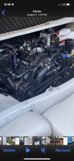

kbryant
Apr 20, 2013
168
For open cooling it shows 7 point (7 blue plugs)
Or single point drain
I need a pic of this handle
I do have single point drain. It has a blue twist handle on front of engine.
alldodge
Mar 8, 2009
44,660
ok that's different then what I thought with 5 blue plugs
You have only one plug
https://www.mercruiserparts.com/bam/subassembly/31503/13808/200
In that case, your playing with maybe's
Maybe all the water drains out, and maybe it doesn't
Fresh water boats have less of a chance to not drain but it's still a chance.
If (note the IF) the system works, open the drain and drain all the water out and your good. Would suggest filling with RV AF in this case because you (mostly me) can not trust the Merc single point drain.
Leave all drain plugs out
