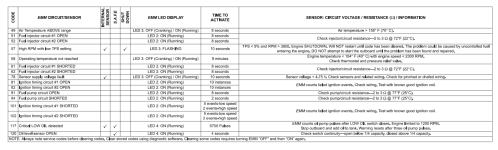

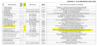

you can check EMM lights (LED) to help out see book for possible conditions at KEY ON AT KEY START ENGINE RUNNING >2 seconds

how is the impeller ... old new ??? EMM may be heating up and causing a shut down till cooled... check water circulation .
EMM log dump of fault codes will tell you if the EMM gets hot...and other issues
