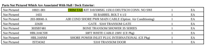

If anyone was having the same issue, I contacted Lenco and they said actuator 15057-001 is the part number IF your Chaparral Signature 310 parts guide kit number is 10021-001. Snipping from Chaparral parts guide below.
