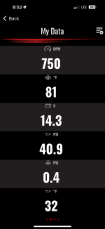

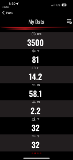

I'm looking for a bit of guidance and a fresh perspective. I do understand the issue should ultimately be diagnosed via computer, and I already have that scheduled.
The problem arises at around 3500 RPMs, where I get a single, constant alarm along with a slight reduction in power. When I reduce the throttle, it transitions to a two-beep alarm that lasts for roughly five minutes. I have VesselView connected, but no error codes are being triggered.
The screenshots below were taken after replacing two sensors. I changed the water pressure sensor, as it was clearly reading incorrectly (PSI should be in the 15–20 range). The oil temperature consistently shows 32°F both at idle and under load. Engine temperature doesn’t exceed 100°F in either condition. Initially, the thermostat was missing from the housing; I installed a new one, but the engine still won’t reach normal operating temperature.
This has me stumped. Oil pressure and voltage readings are within spec. I also used an IR gun to check the risers, thermostat housing, and other areas where coolant flows—none are even close to the expected 160°F operating temp.
I'm hoping to pick someone's brain here, as I feel like I might be overthinking this. The engine isn’t overheating, but it seems like there's too much cooling, which is just as concerning.

Looks like it might be the water pressure reading, 2.2 psi is low for that rpm.
Nord2903
Petty Officer 3rd Class
Apr 24, 2022
76
Agreed, but the engine isn't overheating and that's a new water pressure sensor.

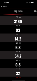

Are the screen shots before or after the thermostat was added back in?

After. Here's a before reading
