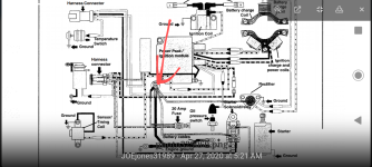

Here is another with similar issue. Look at the wiring scem. Not in color but is this what your book shows?
Doesnt help much, and that is definitely not in my service manual. It shows the harness with like 10+ leads going in from engine side. My harness only has 7 between the two connectors.

Okay, well without a remote you will have to adlib some kind of harness, does your engine have a common lug lime this where all your hots go to? Understanding this is half or more of your battle.

Tap my picture and look, rectifier should go to hot and you can see how the starter wires go....just need to wire in a switch to activate it.
So that starts it and gives you the charge wire.
Do you have any pictures of the motor showing wires, starter and such?
