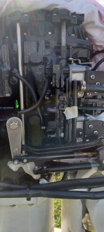

OK... saga continues. New powerhead, redone carbs. Engine sneezes at idle, crossflow line come off fittings (at green arrow, view from starboard), and a spray of fuel comes out of the line.
Can't think of anything other than excessive intake pressure, and don't see any way for that to happen other than reeds going bad (looked OK on disassembly). Thoughts?
Primer solenoid open / leaking?

Didn't think of that, will check next, thanks. It does click as it is supposed, though, and I don't see how it would create overpressure, though.

Except that I am talking about pressure NOT in crankcase, but in the intake tract between throttle plate and reeds. Which should be atmospheric or less, because of the sucking action of the case. And if it is ABOVE atmospheric, as stuff spitting out of the tube suggests, where, in your opinion, that overpressure comes from?

Are you seeing this " leakage " with the hose off a fitting , with the motor running?-----Is this part of the oil recirculation ?
Correct. This is a frame from a video with engine running. The line is the same line shown in the first pic, only the other side, and it was blown off its fitting.
Based on what I am hearing at the local shop, it is supposed to recirculate excess gas from the crankcase back to intake. So, if true, my questions are:
1. Why in the world it is flowing in the opposite direction and where intake pressure comes from?
2. Isn't there a check valve to prevent just that?
4 hours on powerhead; check valves came from the rebuilder with it, so I presume they are OK. The only thing not redone in the intake tract is the reeds, and it was sneezing like that before rebuild as well.
So I was misinformed on that; fuel IS supposed to flow aft (so that bearings stay lubed even if one of the carbs runs lean, I imagine?), and check valves are operational. But what could possibly cause overpressure that blew the lines off?
