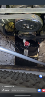

Took the boat out with the kids and while running 4200 rpm for a couple minutes I noticed the boat seemed to be slowing down looked at the oil pressure it was zero🤯 shut everything down motor temp was 170 although it was around 130 everytime I looked at it before. Opened the motor hatch and there was oil all in the bottom of the hull(photo1) had to get a tow back! Now I’m being told a replacement engine is gonna be 12k uninstalled. So my question is what would everyone else do or consider? My thoughts thus far are to repower with the 357 alpha carbed or maybe a long block but I’ve been told I can get a 5.7 long block and swap everything over just like it was a 5.0 long block? Also who and where should I get what I need?

Tons of options. 12K is way over what should consider reasonable. I suppose that is for a new Merc.
Yes, you can get a long block and swap it in. Or have yours rebuilt. There are some pretty decent engine builders for marine engines. No problem swapping in the 5.7 except I think you have to have the ECM reprogrammed.

If it was me, I would build a 377 or 383 stroker.
However before spending any money, find out what happened.

Would also like to know what caused the oil to leak? Did someone just change the oil?

It really depends on what the actual failure was. If the bearings burned up due to a lack of oil that's one thing but if it dropped a valve and it scattered debris all round the cyl that's another.
Does this engine have a standard oil filter mount or a remote mount? Those can leak sometimes.
I would stick with the 5.0 just to not have to change anything else, if your injection system is in good shape etc its worth keeping it as is.
merc MPis have remote oil filters so would check the hoses and adapter at the block
