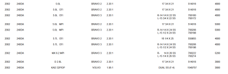

did you look on SeaRays site at the old brochures? you used to be able to see all the specs by year

...yep...Bravo II standard.....B3 optional
53,249
looks like a few options in 2002 for the 240 DA
