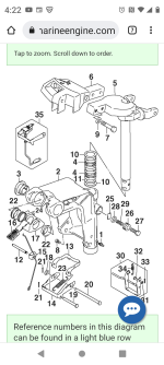

2nd question is regarding steering. It seems to pivot very very easily and I know this is going to be a issue trolling. Is there some sort of screw or tensioner to tighten it up?

As for the steering swivel tension, there should be a spring over screw somewhere below the power head near the top of the swivel bracket.
Part number 27

Screw is item #27------Install a new impeller in that---" JohnSuki"
