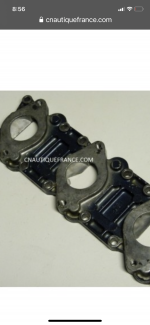

Have another question. Center intake manifold, looks broken, but when I look for replacement they are the same. What is that. Factory? Same failure? Just a question. Weird looking to me.
