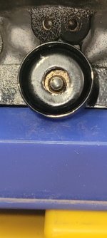

I have this cover over the screw. Can't pull off. Do I cut down the side. Don't know what in there for space

Hi. I’m sure you already know…but thought I’d mention. You need to adjust the idle setting when the engine is warmed up and normal conditions. Otherwise you are fighting other influences
