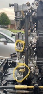

1998 Mec 150 black max
bambisniper
Recruit
May 18, 2022
Missing an accelerator pump stem for one of the carbs. Any suggestions on where to find one???? or ......

Part # 17-810747 - STEM NLA
You might need to get a used carb and salvage the Stem, and likely the Spring under it
Dukedog
Oct 6, 2009
3,547
pumper WMH carbs only lasted 2 years.. last of which was '92... they were a bust for regular boating use.. if your motor has these it is either not a '98 (should be WMV's) or they have been changed??? tha pumps can be eliminated without any repercussions to performance.. simply strip all tha guts and little linkage off, block tha tiny hole at bottom of casting and fill with epoxy.. most high perf guys do this.

It is a 95 sorry and I just need to find that type of carb at a salvage cause everything else is good tk go just need the accelerator pump stem part#810747

tha pumps were added for tha roundy round racing boys.. acceleration off corners and choppy water.. they jus didn't work out as they were supposed to.. they have no effect on idle circuit up or down..
tha '95's didn't have pumpers unless they were some kinda "left over" item merc wanted ta use up or they have been changed.............. last year of "normal production" for pumpers was 1991.................. ya might search ebay for tha early wmh "pumper" for parts....
