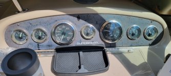

Might want to take a multimeter next time. You are a high idle but the volt meter is low at 13v. Should be at 14v at that rpm. Either a weak battery or alternator issue.
I keep watching the smoke video, that is too much smoke for too long to be valve seals. That looks more like bad piston rings. A compression test really should be done. When it comes down to it, a bad power plant can turn this boat into yard art. Nothing in boating is cheap or easy.
