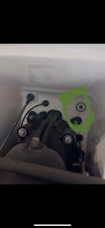

I don’t see a physical water hose connection. I will get pictures by the jet pump and post them. There is one Inlet to the right of the jet pump that looks like it takes water and feeds it to the engine. Do I need to hook a little water hose up to that? There is also a valve in the engine bay under the seat that is inline with the hose that is associated with that inlet by the pump. Does that have anything to do with the cooling system?

Yes, it has the quick connect garden hose male end
Attach hose, and
"Make sure to do it as listed above"

For now since I don’t have the quick connect can I just connect a hose to that inlet to the right of the jet pump?
alldodge
Mar 8, 2009
44,273
Yes, BUT (note the but)
You need a valve to keep water OFF until motor starts, "then" turn water ON
Do in reverse to shut down

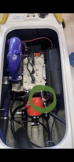

Also one more thing. There is this cylinder like Thing in line with the oil line that maybe is a filter that has what looks to be some chew marks on it. I will include a picture of what im describing and see if you can tell me what it is and if it needs to be replaced because of the condition that’s
alldodge
Mar 8, 2009
44,273
Note sure what it is, might be a oil injection check valve, but again I'm guessing

I’m trying to figure out what the cylinder type tube that is inline with my oil lines on my seadoo 717 engine. It looks a little chewed up and I was wondering if anybody can tell me what it is and if I need to replace it because of its condition. Thanks. DE79C4B3-AA45-4B4F-949C-C4EBDC42DD9B.jpeg
