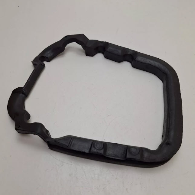

Has anyone attempted to replace the "lower seal" on their cowl?
part #2
#2F684989SEAL-Bottom Cowl Plate (1 required per assembly)
SEAL,NLA F684989
F684989
About Mercury Marine
OEM Part
F684989 - Seal, NLA [ More info ]
Add to shopping cart $56.25
10+ in stock.
Would this seal replacement stop exhaust from infiltrating the
cowl housing restricting FRESH AIR for the single carb in the FORCE 75hp?
My idle seems to change after setting to 900-1000 rpms w/ the cowl off.
When I put on the hood engine rpms drop about 100-150rpms. Is this
normal?
I set the rpms to 1100 with the cowl off and they turn about 900-950
idling at dock. Might go higher if I am out on the water with a little movement
stimulating air flow. Anyone install vents in their hood?
Am I crazy for thinking this?

IF exhaust is getting into the engine, it is not getting in through that cowl seal.
It is getting in from below the powerhead.
From the exhaust gasket / spacer plate / exhaust tube.

..... i can see where the "exhaust gasket" has started to deteriorate some underneath the powerhead and cowl bottom. I guess the only way to
replace that is to remove the powerhead. That's beyond my capabilities.
Any other "fix" options? lol ~
