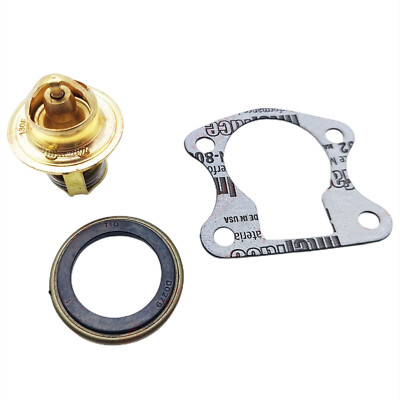

Also I have been buying quicksilver parts but it seems the gaskets are not in some sort of package and something like this looks to be cheaper. Would this be a suitable kit ? Thanks

That kit would work.
The best bet is buy products that say Mercury/Force on the package.
China has made so much junk, you never know what your getting.
Agree with jerry 100 percent......Sierra would be acceptable as aftermarket brand IMO.....and a little cheaper than Quicksilver. Just look at the brand names in the product descriptions on ebay......the one in the link above states it is "UanOfcn"......sounds very Chinese to me......
