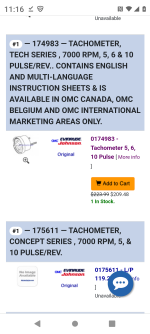

So, I decided to check the stator wires. There are (2). As per evinrude info, 6 pulse, 12 pole.
Problem solved (?)
Aug 20, 2022
15
I found that info on OEM tach instructions.
Wasn’t sure if that would be the info I needed, but based on more research and trial/error it must be correct.
VDO and my Yamaha tech gave me incorrect information.
