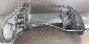

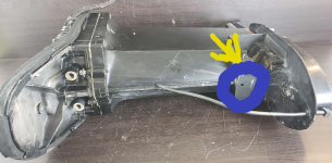

heres a better shot of the hole where the water is coming out of as well as a steady stream out the tell tale and the prop. im not exactly sure but i cant see how water would be getting up in there. ? and out for that matter.

jimmbo
May 24, 2004
14,514
That is a Drain for the Midsection, which fills with water after it is done cooling the Engine, and being that the midsection is about 20 inches tall, it develops its own head of Pressure at the Drains.
