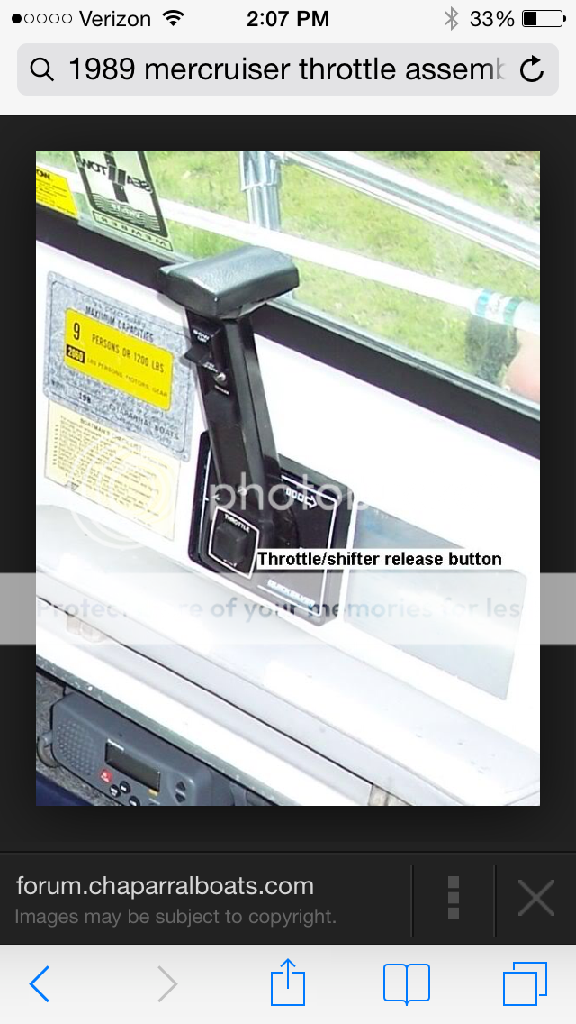

One issue is the throttle control box as seen in a photobucket picture . I know its a quicksilver control on an Alpha One Mercruiser. How does the control box goes back into the side panel? I think it was straight up and down with the cables coming out of the bottom? Quicksilver 1000 Commander I do believe?
http://i937.photobucket.com/albums/...0-1A42-471E-B6C9-BFBA51271FE6_zpsnqueznyb.jpg
http://i937.photobucket.com/albums/...6-B3B4-49FF-8D4D-BE3D981D7142_zpsgj5pnuim.png

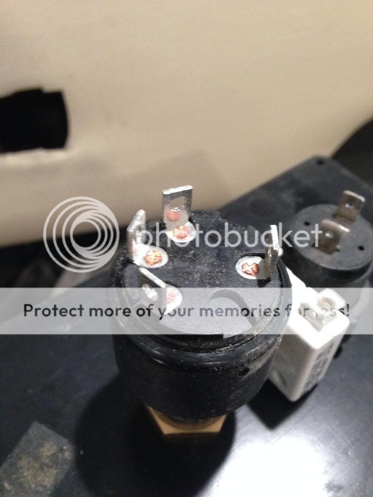

Also is there a wiring diagram for ignition switches? I built a new modern looking dash with guages and bought a new switch but it has 4 connections, not three as in the old with no labeling of what wire goes where?
New switch
http://i937.photobucket.com/albums/...5-9863-4694-91C3-4317C1C0F1C0_zpsdcpncob4.jpg
Old switch
http://i937.photobucket.com/albums/...0-225A-4FA3-9736-D183569C72D2_zpszu6iudog.jpg

The controller usually points the cables Aft, towards where their headed,...
Stick straight up, 'n down,...
If yer old switch is 3 posts, 1 is Power from the battery,....
1 is the Ignition "On" post,...
The other is the Start post, to the starter circuit,...
The 4th position on the new switch is probably Accessory,...
