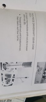

So in the 1990 96, 90, 120, 125 book they mention to screw the shaft in all the way and back out 4 turns. I wonder, are those 4 complete 360 turns or would 180 be considered a turn? My problem engine was out half a turn so completely bad. The other good engine is out 2 full and a half.

Ok I think I got it. I did 3 1/2 out for the lower gear shaft. I Set the interlock shaft and towershaft arm at the same height and in neutral by playing with the 2 nuts. I adjusted the neutral switch cam to the switch button. Adjusted the eccentric roller for idle and the throttle link shaft at WOT. I have to recheck timing to je at 28BTDC again. And see if I get more room for idle adjustment in the water. Plus maybe readjust tye air mix if needed. I hope this does it. That new book I got has all this stuff in it. The 92 and and Clymer did not mention some stuff If you guys have anything to add let me know.
