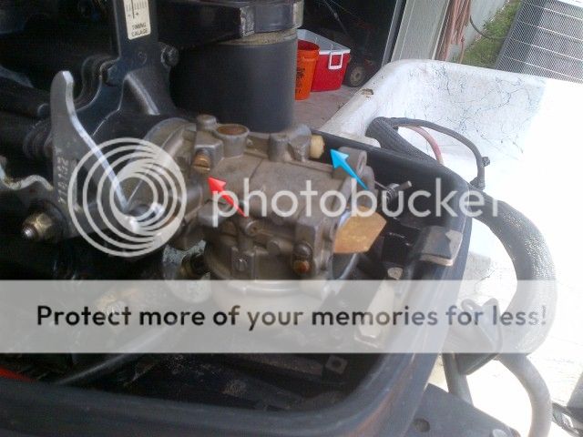

I recently purchased a boat with a 1989 Force 50 two-cycle outboard. I am tuning up the motor and would like to know where I need to set my carburetor screws at and which screw does what. One is brass, the other is plastic. Here is a picture.

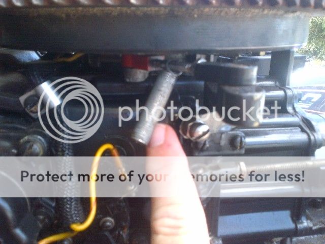

There is also a mystery spring dangling that the previous owner said it has never been attached to anything. Surely it is suppose to be connected to something. Here is a picture of it.

The white plastic "screw" is simply a plug for the air bleed jet. You only remove it for cleaning the carb and you screw it in tight--there is no adjustment.
The brass screw IS a low speed needle and preliminary setting should be 1 to 1 1/4 turns out from lightly seated.
The mystery spring is just that. It was never on any stock force engine. perhaps a previous owner put it there in a vain effort to help return the trigger to idle position. Remove it before it bounces up under the flywheel and causes trouble.
