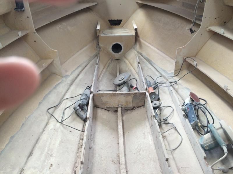

Hi there everyone ! Yes, another complete novice contemplating a restoration !
Had the boat for about 4 years until a few tell tale signs started to appear, like about 30-40 litres of water draining out of the transom bungs after each use.
So, once the fuel tank was removed and I saw how soggy it was underneath, I knew I was up for some work ahead of me.
I cut the floor out and was shocked to see that the fibre glass was delaminating from the stringers, the bulk heads were complete mush and it was in a pretty bad state. A bit of detective work, found that the eye lit in the bow, for the winch strap had at some stage been repaired, however the re enforcing pieces inside were completely rotten, water, I believe, still flowed in, forcing its way around the bunk seats in the cuddy cabin and the rest is history.
I felt it was too bigger job to attempt myself, So I found a local fibre glass shop prepared to take on the work, a deposit was left with him and away I went. Unfortunately, I managed to finally get my boat back off him 6 months later, completely untouched and pretty well worse for ware, left in his yard out in the elements for the entire time !!!! My deposit money was gone !!! while I kick my self for not regularly visiting his premises, his assurances on the phone that the boat repairs were well in hand were very convincing. Currently going the legal avenue to try and get my 3 grand back and stop him from doing this to other boaties.
So, back at square one again, got some quotes from other fibre glass companies, ranging from 9-13k for the work, but after being burnt once, and seeing how much it was going to cost, made me closely look at the possibility of doing the project myself.
The list of work needed, are as follows, new stringers and floor, raising transom to take a 25 inch leg motor, repair eye lit area in bow, reconstruct the cuddy cabin side seats area, possibly putting a kill box in the floor at the rear........
After reading through this forum for the past couple of months and taking on board all the great information there was to be had, I made the decision to have a go at this myself. Now I'm not under any illusions that this will be an easy task, having never had anything to do with fibre glassing, but I'm not one to shirk a challenge !
Oh no !! Another newbie attempting a boat restoration, I can hear you all now LOL
I'm located down under in Australia, after researching here in Melbourne, there are fibre glass suppliers here with all my material needs, but the experience and knowledge here on this forum will hopefully be my greatest resource.
I'll try and see if I have a suitable photo of how she stands at the minute and thanks in advance for answering any questions which will enevitably be thrown out there during my journey.

It looks as though I can break my tasks into 3 specific areas, my transom appears to be sound, but I have removed the old 2 stroke motor with the intention of fitting up a new 4 stroke once complete. It has a very low transom design at the back of which, I want to build it up to take a 25 inch leg motor and probably completely re do the whole transom while I'm there, its a 1988 boat so I chances are it will need doing. So taking that into account, transom work will be done from the outside,
so that should mean effectively that I can start and fully complete the stringers and the floor before I worry about the transom work ?
the third job will be cutting out inside up front to get to the eye lit issue, but to me it looks like I can do each job separately ???? yes

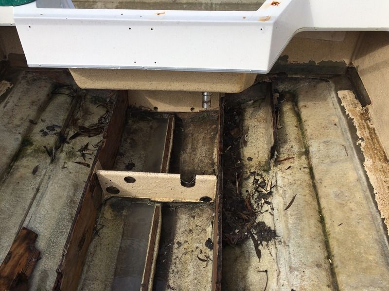

Hi jbcut00, when I removed the floor. the fibre glass basically pulled off the stringers, the stringers then basically fell over, it was so water effected that they were
no longer attached to the hull, I ground some of the old fibre glass from the surrounding area, left the centre one in for hull support and that's when I decided to take it to a professional. As far as the transom goes, I was thinking that because it needs to be raised on the outside section of the transom to take a 25 inch leg, that the inside section could left as is and just repair and alter from the outside ??????
The boat is still on the multi roller trailer, but I have put support timbers to the floor underneath up the centre.
