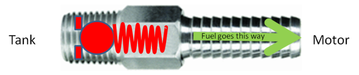

ok fuel issue
There is a fuel restriction, the antisiphon valve, collapsed fuel line or tank pickup tube
The antisiphon valve is on top the tank. Remove the fuel line then the valve. There is a spring and check ball inside
