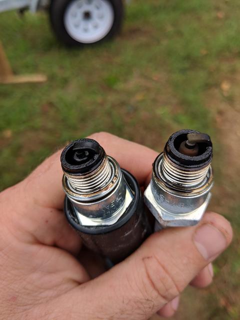

Oh and something else I noticed.The top plug is on the right and the bottom plug is on the left. Looks like top is dry and bottom is wet.
It's seeming like this has something to do with the cylinders/plugs/pistons, though I don't know why any of that would have been affected by a broken midsection.

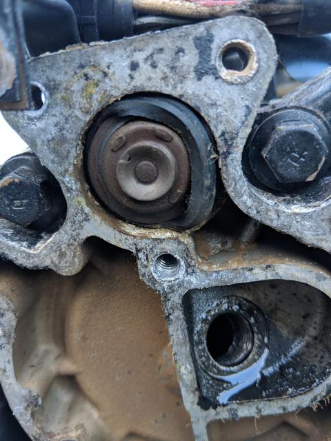

I'm going to guess that there's a good chance you buggered up the lower main seal when the driveshaft was out of alignment. It sits in a small housing at the base of the powerhead and if that housing got cracked, the seal could have moved or been damaged.
Is this the part you're talking about?

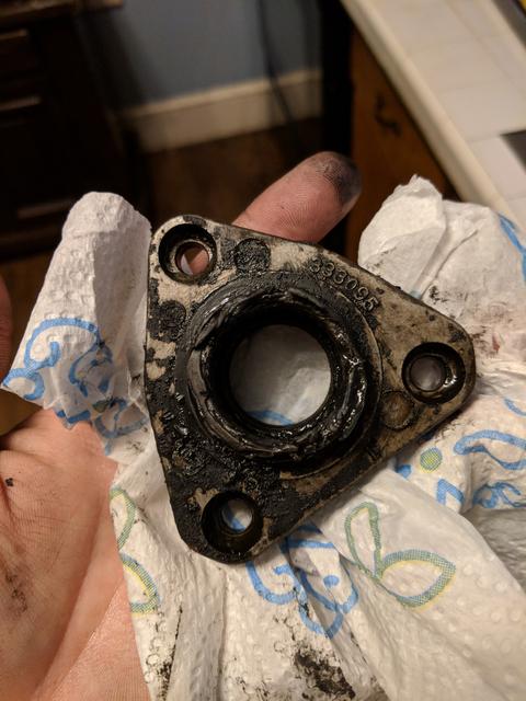

I pulled the powerhead tonight to check out the lower crankshaft seals and bearings. The o-ring (part # 0326649) was trashed. Not sure if that would cause any of the symptoms I experienced but it will certainly be replaced along with all of the gaskets.
I haven't pulled the bearing yet but at a glance it looks to be in great shape.

Put new gaskets on the head and water jacket. Decided to go ahead and replace the lower crankshaft seal since I can't find anything else noticeably wrong.

Well, you nailed it!
Got my new seal last week and installed it yesterday. Put everything back together, crossed my fingers, and fired it up. Pull start was back to normal and the motor sounds like its old self. I guess air was being pulled through the damaged seal, and restricting the movement of the pistons?
