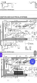

I need a diagram of the wiring for the solenoids . It is three solenoid’s. I am not very good at electronics so I need a picture or diagram. I believe that someone switched motors and didn’t hook everything up.

Ayuh,.... Welcome Aboard,.... Which solenoids, for what,..??

I hope this helps you, the first is basically the overall diagram and the second is a closeup of the area I believe you are talking about.
