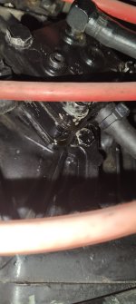

I assume you mean the fuel pump mounted on the outboard...not the hand pump off the fuel tank.
Just found this! Looks like this could have potential? This is the fuel pump sending block thing on the side of the motor.

Honestly, haven't checked the one on the side of the outboard. Assumed since I Had fuel in the bowls it was working. Even without it working wouldn't it run at least for a few seconds?
Mine didn't run...if I remember correctly, I read that it pumps thru the filter/ to the carb...but under full throttle also pushes fuel directly into cylinder #1.
