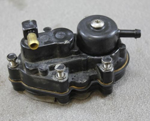

The Crowleymarine web site shows a figure 8 pump style for that IL6 serial number. It is roughly the shape of the old baseplate.
Here is what it looks like.
You might look for a used one.
