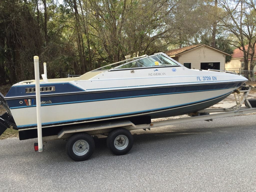

One of my recent project boats I restored was basically the same boat. It was a 1985 Wellcraft Pan American 192 pictured here:

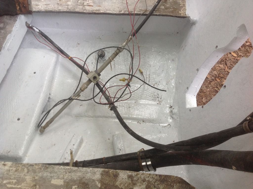

Here's what you will see when you pull the engine to give you an idea of what will need to come off next:

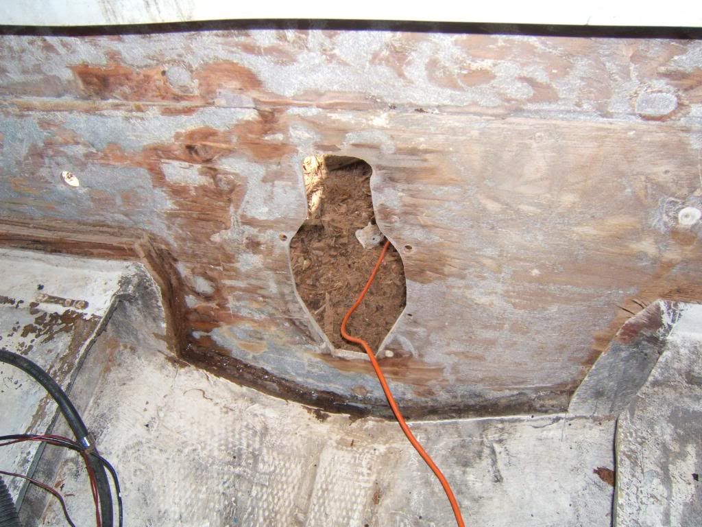

The transom on that boat was rotten. I ended up having to strip it down and put new plywood and fiberglass...
