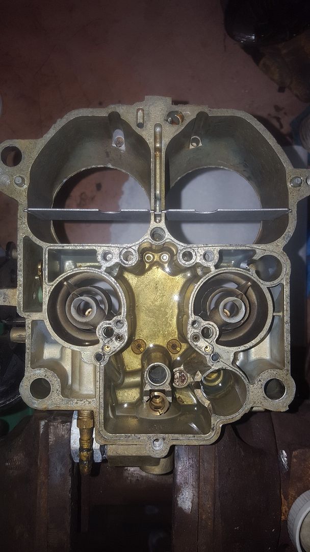

Well, After removing the carb and buying a kit I have checked the welch plugs for leakage, I used compressed air and soapy water and have filled the carb bowl with gas letting it sit for hours and no leaks. So what now, rebuild the carb with the new kit and hope for the best???

Choke working and set properly? Pumping the throttle a few times before cold start?? Does the accelerator pump squirt fuel into the carb when throttle is pumped? Some of those carbs have porous castings as well. Verify that there is fuel in the float bowl before attempting a start.
