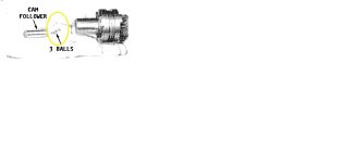

This prop shaft does not have any bearings. I am suspect that they came from the shifting spline shaft or the drive shaft.
Sorry I was mistaken. I found where the 3 ball bearings go...lol
And yes, I found the roller bearing on the prop shaft. all bearings seem to be ok.
I have come to the conclusion that if I need to replace the roller bearing on the drive shaft I will have to take it to a shop. I do not see any issues with that bearing either. I guess Im going to put it back together with those 3 ball bearing in the proper place and see how things go.
