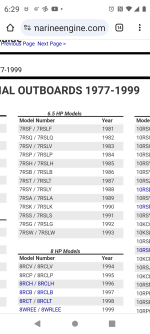

How would I order a carb kit for ab 86 , 6.5hp commercial motor nobody lists a 6.5

Hello thanks for the response , so I'm curios how do I look up parts for a 6.5 , are they the same up to 8hp ? Just can't seem to find these motors listed in any parts source ?

Here is more info.

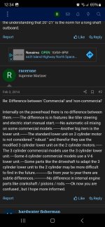

Are you sure cause I posted a picture of a post you made ,stating that the lower units are modified 3cyl units ???? Which is correct
Honorary Supreme Mariner
39,991
That refers to the difference in gearcases on the 2 cylinder 45 HP , yes 45 hp outboards.-----The 2 cylinder 40 / 45 / 48 / 50 / 60 HP gearcases are not known to be robust !!----Therefor the 3 cylinder 70 HP was adapted for them.-----The little 6 / 7.5 / 8 HP motor does not need the " monster " 25 / 35 HP gearcase !!!
