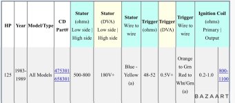

I found out when ohoming my stator I only get 332 instead of 500-800
jerryjerry05
May 7, 2008
18,196
Is the stator new? CDI stators can read lower than OEM.
Borrow/buy another meter and see if that makes a difference?
Lots of times, if theres any type reading it can be good

I used 2. Meters and got 328 on both and 332 stator was also oem I believe and trigger test good as well

Just check the resistance (Ohm) for the trigger and stator are not 100% they are good.
The DVA voltage output from the stator and the trigger give you the answer if they are good or bad.

Shouldn’t the numbers be somewhat close ?
