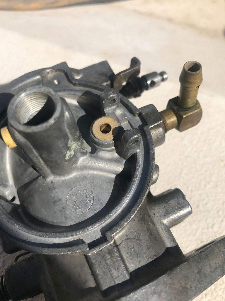

I got a an 1984 125hp force outboard model 1251x5a
Motor runs good for a wile but then it bogs and cant run at low idle speed.

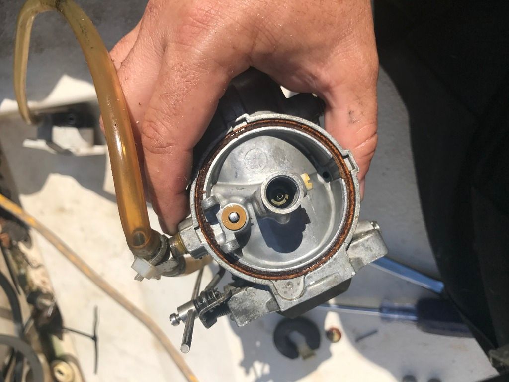

So I removed the carbs and found that one has a needle missing so that is why the carb was flooding and making the engine stall at low rpms
As you can se on the pic
Compared to the other one.

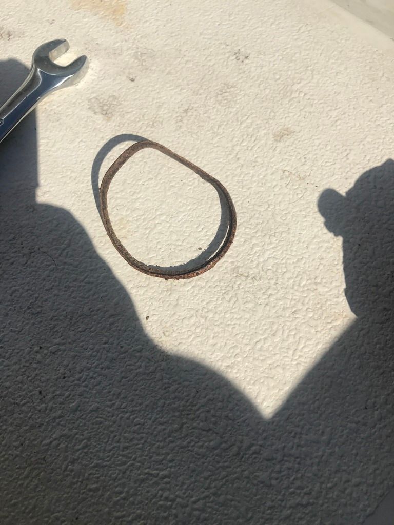

Also I need this bowl gasket
Where can I find this parts?

Maybe someone could tell you where to find the exact part, but I'm thinking maybe find a Neoprene O-ring or Quad-ring to use in place

If it is a TC carb ex Maxrules has a carb repair kit that is complete except for the float.

FK10103 rebuild kit.
FO15623 gasket, bowl
FK10107 needle/ seat
1/4" fuel line.
This site has some of these parts.
O-rings won't work in that application.
The gasket edges are squared off.
​The next time, spray the carb with WD or any lube.
That gets the gasket wet and you can possibly use it again.
The "kit" contains a bunch of parts that don't necessarily fit the carb you might have.
​Make sure the new needle is the same size as the old one in the second carb.
Rebuilding can be tricky if your not sure what to do?
If it isn't dirty just replace the needle and gasket.
