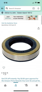

Any idea what the part number is? Searching online but not having too much luck. Is this it 26-89238

Chris - I cannot thank you enough!
Replaced the seal (old one was shot), finished replacing the impeller and water pump base, put it all back together and it held 15 psi for over an hour. Hopefully that’s the end of the water leak!
