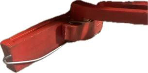

Does anyone know to where this little straight spring connects? its underneath the red piece that sits in that starter bracket.

The spring gets set up to always put pressure on the red arm towards the starter sheave. One end will go around the tall metal tab.

I believe the spring holds the red arm away from the sheave.
